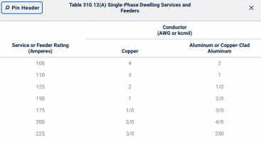

In 2013 I built a home. I remember talking to the electrician about his choice of conductor sizes for the following scenario:
The service conductors were fed from the POCO pad-mounted transformer between houses in the development. The service conductors came directly to a 200A combination meter/service disconnect which is typical in Florida. Technically, the only service conductors were the lateral feed wires from the POCO to the combo pack seen below.
(click to enlarge)
Coming out of the bottom lugs of this 200A combo pack were 2/0 awg copper THWNs going to my MLO panel in the garage which acted as my main panel and provided 100% of the house load. So far so good, right? After all, Section 310.12(A) & Table allow 2/0 awg copper for a 200A service & feeders for an SFR. See Table below.
(click to enlarge)
Normally, a 200A service or feeder would require 3/0 awg copper conductors per NEC 200.16
Would it make any difference if the combo pack outside had a 60A circuit added to it for a pool panel?
Would NEC 310.12(A) make a difference? Personally, I don't think it matters if there is a shared load because the verbiage of NEC 310.12(A) concerning the sharing of the load would not apply because the 2/0 feeder to the MLO is just that, a feeder and not service conductors.
Do you agree?

First, what code cycle is that? Here we are under the 2017 and the applicable artical would be 310.15(B)(7).
And yes the install you propose would be compliant with 2/0 as the conductors to the inside panel would be a feeder and covered by this section.
310.12(B) Feeders.
For a feeder rated 100 amperes through 400 amperes, the feeder conductors supplying the entire load associated with a one-family dwelling, or the feeder conductors supplying the entire load associated with an individual dwelling unit in a two-family or multifamily dwelling, shall be permitted to have an ampacity not less than 83 percent of the feeder rating. If no adjustment or correction factors are required,Table 310.12 shall be permitted to be applied.

Look, you have a 200A nominal residential service. The service conductors need only have an ampacity of 83% * 200A = 166A, per 310.12(A). What 310.12(C) is telling you is that any feeder on that service never needs an ampacity of more than 166A. So that makes a difference for a 200A nominal or 175A nominal feeder, but makes no difference to the 60A feeder for the pool.

The language in question first showed up in the 2014 NEC, and if you read the 2014 Report on Comments (second round of revisions), it is clear the intention is as I described. (https://www.nfpa.org/Assets/files/AboutTheCodes/70/70-A2013-ROC.pdf and see in particular Comments 6-43 and 6-52). At one point the text was going to be "In no case shall a feeder for an individual dwelling unit be required to have an ampacity greater than that of its 310.15(B)(7)(a) or (b) conductors." Perhaps you find that clearer and they should have stuck with that?
Also, let's try this argument: Suppose 310.12(C) said "any other feeder" instead of "a feeder". Would that make it clear what 310.12(C) means? If so, consider that the 310.12(B) feeder also gets to use the 83% factor. Combine the 310.12(B) feeder with "any other feeder" and you just get "any feeder," i.e. "a feeder", the language of 310.12(C).

OK, let's try this one more time:
310.12(A) covers services "rated 100A through 400A" and "supplying the entire load". 310.12(B) covers feeders "rated 100A through 400A" and "supplying the entire load". No problem.
310.12(C) says "In no case shall a feeder for an individual dwelling unit be required to have an ampacity greater than that specified in 310.12(A) or (B)." The phrasing "In no case shall a feeder for an individual dwelling unit . . ." (indefinite form) means any "feeder for a dwelling unit" is covered; there's no restriction on size or "supplying the entire load." The value referenced is the "ampacity specified in 310.12(A) or (B)."
Great, so the ampacity for what service "supplying the entire load" or feeder "supplying the entire load"? It is clearly implicit that it is the service or the feeder that is supplying the feeder that you want to apply 310.12(C) to (aka the "upstream" feeder or service).
So the upshot is that if you have a 310.12(A) service or 310.12(B) feeder, then any further feeder it supplies (aka "downstream" feeder) shall not be required "to have an ampacity greater than" the specified ampacity for your 310.12(A) service or 310.12(B) feeder.
Not the most elegant wording, but not really any room for debate.
