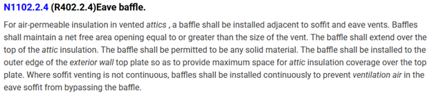

Informative New 2024 Eave Baffle Code
My take on this is almost EVERYONE interprets N1102.2.1 wrong.
Where R49 is required and R38 is over 100% of the attic is misunderstood by many.
100% coverage means, no thermal bypass or bridging. AKA Continuous and not in the cavity.
The 100% does not allow for framing.
Then, the insulation must continue over the top plate of exterior walls.
Think about it....
The U for 2x10 @ 16" O/C with R49 = 0.027
The U for R38 Continuous = 0.024
(U values created with Rem Rate 16.3.4 assuming Grade 1 or perfect install)
The exemption for the less "stated" R value provides more of a reduction.
Why would an exemption be given for an area measuring 3.5" - 5.5" x the exterior perimeter ???
Understating basic B.S. allows us to discern the difference from B.S. and the other B.S... ©

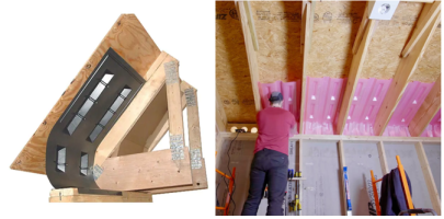

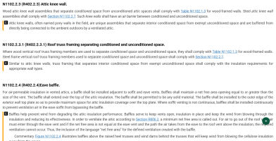

The reason for the wind wash baffle and insulation thickness for R-38 outside of plate to outside of plate is to first prevent air circulation in to the end of the insulation decreasing its value, second prevent the wind from displacing insulation at the eves, third to proved full thickness insulation to the outside of the plates. The code tries to make up for reduced insulation thickness (and R-value) at the eves below R-38 by increasing the R-48 for the balance of the ceiling- roof.
Ventilation chutes installed in cold roof assemblies combined with attic ventilation is maintain the attic at close to exterior temperature in the winter to prevent ice damming, to provide a path for moisture escape.
Note, hot roof assemble are another seperate discussion.

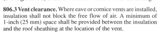

Your attics are still vented ? Soffit vents and ridge/gable vents ?
My home was built in 1969 with a combo of soffit and gable vents. Since gable vents are rare in new construction because of the wind zone which limits the percent of gable ends (most are all hip) we see mostly unvented attics but there are millions of homes with vented attics.
