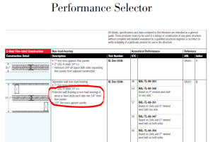

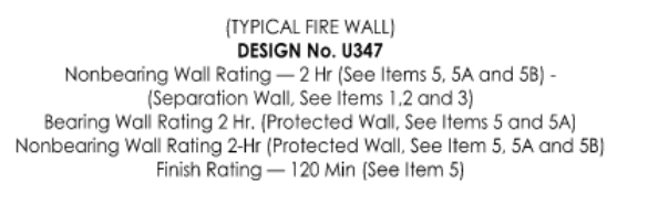

What is a double fire wall assembly? Not defined or described by the IBC as far as I can tell, loosely described in NFPA 221. I'll illustrate it with a specific proposed assembly, U347. Is U347 (below) a double fire wall assembly?
Or, is it two 1-hr walls? Or is it two unrated or rated supporting walls in plane on either side of a single fire wall comprised of 2 layers of shaftliner that has a 2-hr FRR by itself?

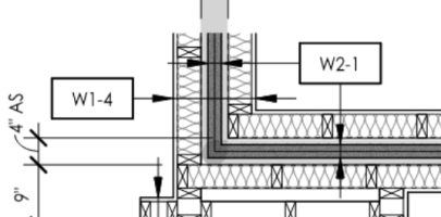

The DP illustrates the walls this way. He shows the 2-hr FW as W2-1 as only the shaftliner core, and the framed walls on either side as 1-hr walls.

That is not a double wall IMO....The 221 double wall concept just lets you make each "exterior wall" bearing and a lesser rating than a single wall....I believe the U347 is a facing wall and that facing wall is needed for the temp rise on the other side, IE, it is part of the rating....

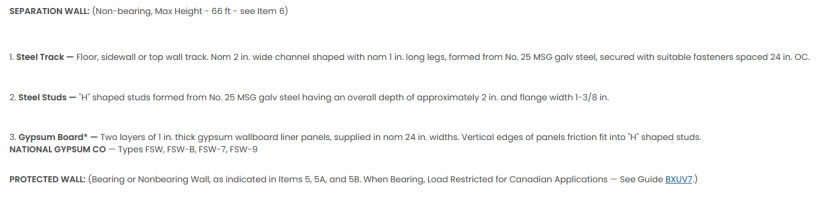

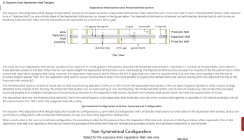

UL calls it the "protected" wall
