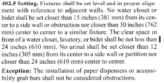

I need to reconfigure an existing multi-user restroom for ADA. To get more space for ADA fixtures, I need to relocate the non-ADA wall-hung lavs, squishing them together as closely as possible.
In the past, for a 17" wide x 19" deep wall-hung nonaccessible lav, I've typically seen (A) 15" from and adjacent side wall to centerline of lav, and (B) 30" o/c for all other sinks thereafter.
Are either of them CODE minimums, or can I go less than that for either (A) or (B)?
(If they are in a code, please help me find the actual reference. Thanks!)

Thanks, Steve Ray. I just now found it in the California Plumbing Code in 402.5 "Setting". Apparently, CPC is similar, except that it is silent on lavatories, and it lets urinals be closer: 12" to a side wall, and 24" center-to-center.

Thanks everybody, but to repeat, the original question is solely about spacing of NON-ACCESSIBLE lavatories, not accessible fixtures.
The only thing in the CPC is ..."The clear space in front of a water closet, lavatory, or bidet shall be not less than 24 inches..." So, I read that as 24" wide by 24" deep.
