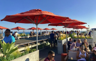

I have seen the Los Angeles Building Department approve a 1500+ SF roof deck separated into multiple 750 SF roof decks so that it would not get classified as an "A" occupancy. The separation is typically a bunch of raised planters / raised skylights with a maximum 4' walkway between them.

Wow. But wouldn't each one need its own means of egress? And wouldn't they all converge? Surprised something like this would get away!

My guess is that it was an occupancy group classification issue rather than an occupant load issue. A Group A occupancy may not have been permitted at that height based on the construction type of the building. Thus, they could be classified as Group B which would allow a higher level location.
Each would need its own means of egress, but the roof level would still need two means of egress based on the combined occupant load for the two rooftop areas. One area could egress through the other to reach that area's exit for the second means of egress.

That's exactly what it is.
