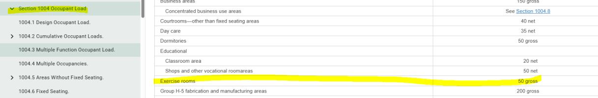

I am an architect in Florida and the FBC allows business occupancy for martial arts etc at 50sf/person.
My client has renovated a warehouse to run his small dancing school of max 15 kids per session (without a permit) He has been doing this for 9 years. The warehouse has a space that is 740sf. I am helping him legalize his space.
The building official (architecture) accepts B occupancy classification however the fire official says it either has to be business (150sf pp) or assembly (15sf pp). As a small business sole proprietor, the upgrades required for Assembly will be too expensive.
The official and fire marshall said they would allow me to put forth my best argument for a 50sf pp rating. Can anyone help me?
AI suggested using a concentrated business use designation. The fire official has never heard of this argument.
Any help would be appreciated. Thanks

so to clarify a few things. The Florida Building Code would allow this at occupancy class B, 50sf per person. The Fire code which is a combination of NFPA and florida specific rules, does not have this category. The space is completely open but only 22' wide. There is no room for a performance. This is a class for kids, and they need about 50sf to do the dance moves. Maximum class number of students in 9 years has been 11. I appreciate all your responses, and will study them tonight after work.
What is frustrating is that the building official says it 'may' be a class B but defers to the fire official, who has always classed these types of spaces as Assembly. But the fire official also defers-- to the fire marshall, who seems a bit flexible or at least willing to listen. They agreed to listen to my best argument.
101 is probably being used as exercise area without equipment at 15 rather than 50 w/equipment. I've run into this issue with gymnasiums in schools
1004.5 2023 FBC​
The number of occupants shall be computed at the rate of one occupant per unit of area as prescribed in Table 1004.5. For areas without fixed seating, the occupant load shall be not less than that number determined by dividing the floor area under consideration by the occupant load factor assigned to the function of the space as set forth in Table 1004.5. Where an intended function is not listed in Table 1004.5, the building official shall establish a function based on a listed function that most nearly resembles the intended function.
Exception: Where approved by the building official, the actual number of occupants for whom each occupied space, floor or building is designed, although less than those determined by calculation, shall be permitted to be used in the determination of the design occupant load.
Similar to 1004.5, FFPC 7.3.1.1 lets the AHJ set the occupant load, but based on OP's original statements it sounds like the FM is firm on calling this an exercise room without equipment, which is 1/15.
I'm assuming the money issue is related to restrooms, since even at 1/15 you're at 49 occupants, which should be easy to egress. So, tell them this space complies with the egress requirements of FFPC (assuming it does), and all other regulations are per FBC. FPC says to calculate it per FBC, not FFPC, and if the BO is ok with concentrated business, then calculate your fixtures at concentrated business.
It's a dance studio. Are there ballet barres on the walls? If so ==> "equipment."
