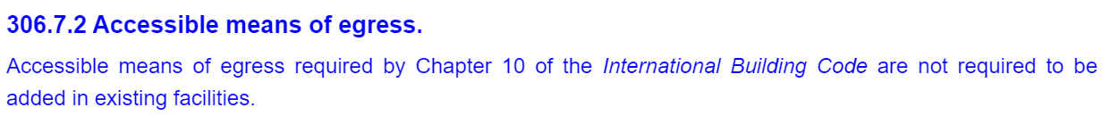

due to occupancy change, city wants to look afresh at everything. fire department now wants me to assign occupant loads to the former pool / now patio area. Honestly, it's just a designated smoking area, but I can't find anything. in Table 1004.5 that resembles it. when it was a pool, occupant load was under 49. Now that it's filled in, if I use "tables and charis at 15 SF/person, I exceed 49 and 2 exits are required. I can't do this because 2nd exit would not be accessible - - it would dump into the parking lot.

Got it. It is a structure and provides some shelter, so I would be similar to @steveray and assign an OL and issue a CO. But the garden area, I'd be unlikely to get too involved with other than making sure an accessible route is provided.
