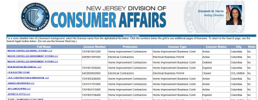

Gotta love when a landscaping company in NJ does structural changes. I guess there are no state licenses there. Or permits.
Now Jar,
You know better, Columbia NJ might as well be in PA, it's just over the Deli up north and a stones throw from Stroudsburg.
and, Jersey has had something you would call a State License for over 2 decades, it's what PA modeled their Home Improvement contractors License after.
I would agree it has very little teeth to it, more of a registration than license, and without it only the home owner themselves can take out a building permit, but who thinks work is not done without permits, in area's that require permits.
And yes Jersey has required permits be taken out for "new" window installs since the late 80's, which is as far back as I can remember off the cuff.
And technically, the company advertising the video does have one of those so called NJ Licenses, but what good is it, if people don't follow the rules.
