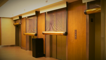

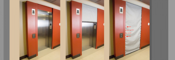

Here are some picture examples. 2-curtain examples, and 1-door example
They aren't pretty when deployed but I'm leaning toward the middle photo above. I believe those are magnetic and run down the face of the elevator frame with no extra rails. If you drop a soffit above the doors you don't have rail "extensions" that run above the elevator door and look out of place. Seems like the most "invisible" option.
