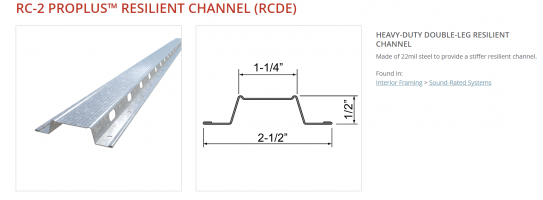

Your interior wall should resist 5 PSF of lateral load. Instead of using 5/8 wood I would look into a Resilient Channel Product since the metal product provides more resistance to deflection than wood.

Use steel studs. Those furring channels are for furring, not framing. You can get steel studs as thin as 1-5/8". They use them in NYC for building apartment interiors, and they support kitchen cabinets.

If sound control is an objective it takes a mechanical break like resilient channel. I haven’t seen that in your posts so far.
