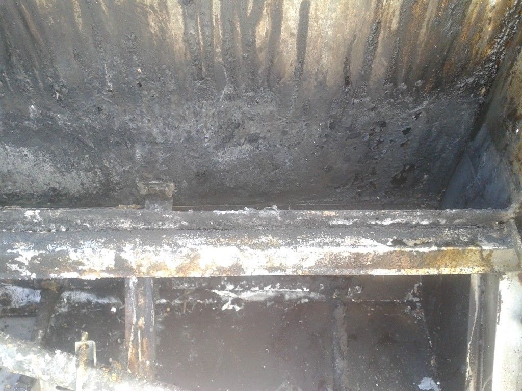

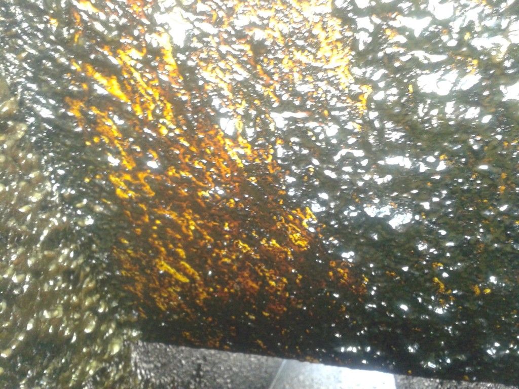

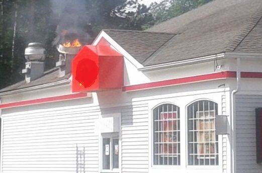

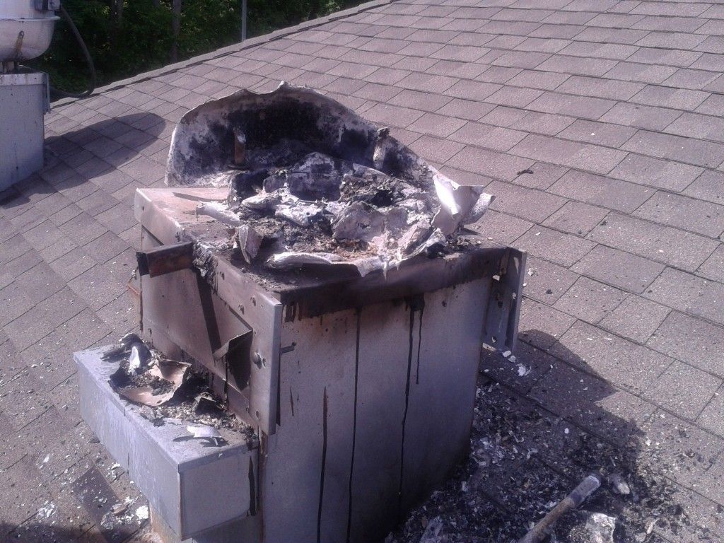

Definitely make them comply with new work all the way through, proper clearance, black iron welded seams, liquid tight. Had a fire in a greasy burger place a little while back, they swear and the tags said they were clean in the past 60 days before the fire. Looked like a candle coming out the roof fan. Proper installation saved the building, out of business for a month while cleaned, new hood fabricated and installed. BTY the nozzles on the extinguishing system were so greased up nothing came out then the system was tripped by the manual pull.
on arrival
fan damage
the fryalator
grease build up in the grill duct
burn out duct
burnt hood above the frylator
