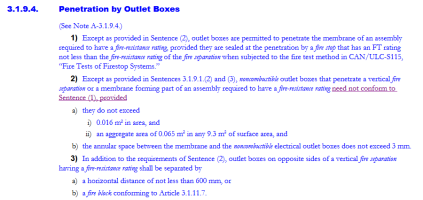

I have an architect telling me that you can have noncombustible outlet boxes directly opposite each other in a rated wall if putty fire stops are applied.
I interpret this application requiring a fire block (sheet metal, lumber, etc).
Thoughts?
I do not see how the requirement from #3 that notes being in addition to #2 requirements would somehow affect the exception #1. The way I read this code section outlet boxes with the appropriate putty pads could be placed opposite each other based upon exception #1. But I do not speak Canadian.
The way I read it, the requirements of #s 1 and 2 are met. However, if you wish to place outlet boxes on opposite sides of a vertical fire separation, you need to meet #3, as these requirements are in addition to #s 1 and 2. Am I crazy?

I am curious. Is there a stated life span for putty pads? Have you encountered pads that relaxed to the point of openings being created?
I contacted Hilti and they confirmed that their pads are appropriate for this application. So I confirmed with the architect he is good to go.
Pads <> fire block in this instance. I'd accept "bulkheading" one of the outlets with F/R drywall, though.
Pads are a fire stop, not a fire block.
I put in an interpretation request, I will try to remember to post the answer here when it comes in, which could be months away.
Augh. The backward < makes my comment look like "Pads are not equal to a fire stop rather than what I intended, which is Pads > fire block, ie, Pads are better than a fire block.
Insufficient coffee when posting.

You'll get limited mileage (kilometerage?) out of IBC references in Canada.
Does the CBC have a different distinction between membrane penetrations and through penetrations? Item #1 in the code section you reproduced specifically addresses membrane penetrations, so I suspect the concept is the same on both side of the border.
Our favorite answer: it depends.
Assembly vs. membrane approach to rating impacts it.
That clause has more to do with the location of the firestopping material to ensure it does not enter a cavity than dealing with membrane vs. through penetrations.
