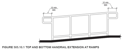

were in the IBC, A117.1 or 2010ADA say the handrail must break at the ramp break and extend the 12-inches from the handrail's break point?
A117.1-2017 505.10.1 Top and Bottom Extension at Ramps (partial quote, emphasis added)
Ramp handrails shall extend horizontally above the landing 12” minimum beyond the top and bottom of ramp runs.
A117.1-2017 Figure 505.10.1 also shows the handrail extension starting at the end of the sloped ramp surface.
A117.1-2017 505.10.2 Top Extension at Stairs (partial quote, emphasis added)
At the top of a stair flight, handrails shall extend horizontally above the landing for 12” minimum beginning directly above the landing nosing.
A117.1-2017 Figure 505.10.2 incorrectly shows the pitch break location, it is not directly over the nosing.
If the handrail extends 12-inches from the handrails break and complies, even though past the ramp/landing break, does it comply?
I would not consider that to be compliant per the two provisions cited above and this one…
A117.1-2017 505.4 Height (partial quote, emphasis added)
Handrails shall be a consistent height above stair nosings, ramp surfaces and walking surfaces.
In context, “walking surfaces” refers to the landing. Therefore the handrail extensions over the landings must be the same height as the handrails, and the only way to achieve that is if the pitch break starts vertically above the intersection of the ramp and landing.

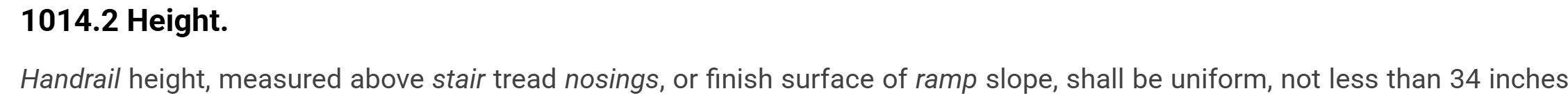

Just an FYI to all, revised figures for all of the handrail sections under 505 in the 2017 A117.1 are part of the revised pending release open for public comment now. I will post the link later tonight for all.
And I too use the term Break, not in conjunction with pitch, but I was following your thoughts to words on this.
Currently, the IBC, 2017 A117.1 & the 2010ADA state between 34-38 inches & once at the landing minimum of 12-inches is required to be level for the extensions.
The code only says uniform between the heights, not parallel to the slope of the nosing's or or ramp run.
QUOTED Section in pic below:
As thus, I have had many debates with designers with code officials in the mix on the difference in heights on the ramp surface from the landings, when it comes to handrails.
Other that the figures, which again are not enforceable, were in the code does it say the handrails upper extension and the slope can't be installed at 37" high, and then the handrail continues to slope past the break over the lower landing to a point at which time it levels off at 34 1/2" and then runs level for the required 12-inches?
Again thank you for your responses and input on this topic.
Regards - Tom

2017 ANSI A117.1 fig. 505.10.1 shows the extension projecting 12" beyond the post and returning to the post instead of directly to the ground.
I was hoping you were going to point to the figures in A117.1 as part of your reasons.
I think the text is clear, the figures simply support the text, they don’t make the argument. Do note I called out the error in Figure 505.10.2, it is an error because it contradicts the text.
It doesn’t have to use the term “parallel.” Disregarding allowable variations in riser height and tread depth (per 2021 IBC 1011.5.4), when the handrail height is uniform over the stair nosings or ramp surface, the handrail is parallel to the reference plane of the stair nosings or ramp surface.

I’ve shared the provisions I think clearly support the requirement that the pitch break must occur directly above the intersection of the ramp and landing, I’m not seeing what I consider an adequate response to indicate otherwise.
I agree with walker.t on this point.
Since the code & Standards don't publish a definitive height for what a purse or backpack or draping overcoat belt hanging loose will catch, what is your technical requirements for meeting this?
“Comply with the requirements for handrail returns.” As you note, the code does not have language regarding avoiding snagging clothing, therefore there are no technical requirements (meaning required by code) you could offer designers when you talk to them about the topic. About the best you can do is to tell them to make sure they comply with the requirements for returning the handrail extensions per A117.1-1017 505.10.1 (ramps) and 505.10.2 (stairs.)
