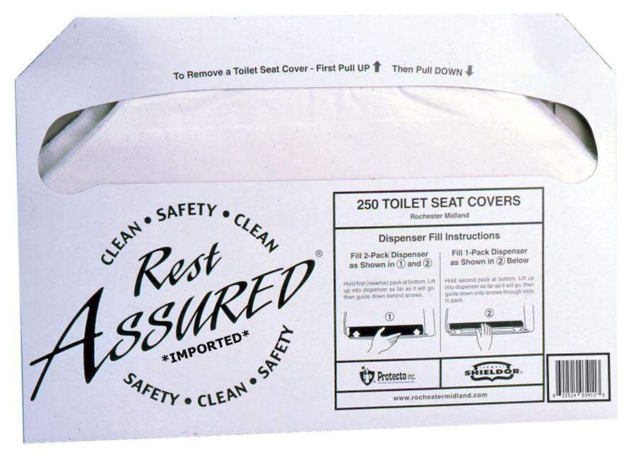

But I believe the "paper cowboy hats" are allowed inside the toilet area.
consider a paper towel dispenser mounted on the rear wall between the WC & the side of the Lav, that projects more than 4" but the height of its dispensing opening is less than 40" but higher than 27" ?
747336_p
Paper cowboy hats, usually behind and above the toilet
I heard of a study recently that found more bacteria on the toilet seat covers than on the toilet seats themselves. Toilet seats are designed and constructed out of material that restricts bacteria. Paper on the other hand, is great at trapping and giving them food to grow.
