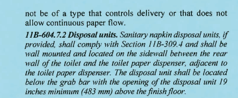

What I’m curious about is the personal hygiene receptor that is forward of the toilet paper dispenser. It is at a proper height, but I am unable to determine whether there is a requirement for how far forward it can be. I’m assuming I should be able to find something about this in chapter 3 of the ANSI standard 117.1, but I am unable to do so. What are your thoughts on this? Is there even a specification or requirement that applies to this and if so, what is it?

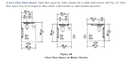

Not so fast. The original ADA, and A117.1 prior to the 2003 edition, allowed one-half of a lavatory to overlap the water closet clear floor space. If the building was constructed in 2004, depending on when it was permitted and what codes were in effect, it may be compliant.
Original ADA:
1753308619399.png0
UFAS 1984:
Looks like I don't have scanned versions of A117.1 prior to 2003, but I'm 98.37% certain they'll agree with UFAS and the original ADA.

I was thinking it would be in 604 Water Closets and Toilet Compartments.
First off, we know it’s OK to have a sanitary napkin receptacle over the toilet clearance per:
A117.1-1017 604.3.3 Clearance Overlap
The required clearance around the water closet shall be permitted to overlap the water closet, associated grab bars, paper dispensers, sanitary napkin receptacles, coat hooks, shelves, accessible routes, clear floor space at other fixtures and the turning space. No other fixtures or obstructions shall be within the required water closet clearance.
“Sanitary napkin dispenser” is only mentioned that once in 604.3.3. As far as reach from the toilet, there’s nothing I could find. I’d say that if the intent is that someone be able to reach the dispenser from the toilet that it be located in an area where the toilet paper dispense could be located.

Clear Floor Space. The minimum unobstructed floor or ground space required to accommodate a single, stationary wheelchair and occupant.
Figure 28 (section 4.16) provides minimum clear floor space dimensions for toilets in accessible "unisex" toilet rooms. The dotted lines designate the minimum clear floor space, depending on the direction of approach, required for wheelchair users to transfer onto the water closet. The dimensions of 48 in (1220 mm) and 60 in (1525 mm), respectively, correspond to the space required for the two common transfer approaches utilized by wheelchair users (see Fig. A6). It is important to keep in mind that the placement of the lavatory to the immediate side of the water closet will preclude the side approach transfer illustrated in Figure A6(b). To accommodate the side transfer, the space adjacent to the water closet must remain clear of obstruction for 42 in (1065 mm) from the centerline of the toilet (Figure 28) and the lavatory must not be located within this clear space. A turning circle or T-turn, the clear floor space at the lavatory, and maneuvering space at the door must be considered when determining the possible wall locations.

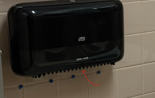

Sharp teeth on bottom of TPD not allowed per 609.5 surface hazards, 5' wide by 5' deep clear floor space required around toilet, SCD access is obstructed by the toilet, SCD is required to have an un-obstructed side or forward approach space with maximum 48" high reach to the tip of the tissues being dispensed. See attached from the US access board site.

609.5 has both a scoping (location) qualification and prescriptive requirement that uses subjective adjectives: "Grab bars and any wall or other surfaces adjacent to grab bars [location] shall be free of sharp [subjective] or abrasive [subjective] elements and shall have rounded edges".
  • How do you determine that the nodules/teeth shown in the picture below represent "sharp teeth" / "sharp or abrasive element"? Just because it can help tear toilet tissue, does that mean it is too sharp or abrasive for human contact? What radius on the nodules prescriptively defines an edge as "rounded"?
  • If you believe it is sharp or abrasive, then from a scope/location standpoint, how is this toothed edge that is recessed under the bottom edge of the dispenser considered adjacent to the grab bar?
For a person who is one handed, I'd think that some type of edge that can assist the user in tearing the TP would be helpful for compliance with 309.4.
