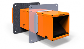

I sent an email to Hilti and they do not have a tested UL system for this application. They didn't even have a solution.

In looking thru the pages of the 3-M resource provided
by
** Mark Handler **, it appears to be multiple workable
solutions to this "multi-pex piping penetrations" conundrum.
From Pass Thru Devices, to using a fire rated caulking, to
using fire rated putty pads, to fire barrier blocks \ planks,
and more.
I too believe that the Inspector is correct is their
interpretation of the need for fire rated protection of the
pex piping penetrations........Just because the details for
such penetrations were not on the plans, is not his fault.
IMO, ...it is time to contact 3-M or another quality fire
stopping manufacturer and get their input........Their
recommendation for an approved fire stopping system
could be accepted by the AHJ........Provide all of the
documents to the AHJ and request that the recommended
fire stopping system be accepted, and move on......Remove
opinions from this problem and submit proven
documents that support the workability of a recommended
fire stopping system.
The pictured product is from STI.......It is the EZ Path Series
44+ Fire Rated Pathway.
This is only one solution.
FWIW, ...the homeowner will need to pay for this "required"
fire stopping.
