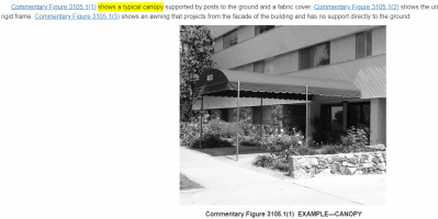

The provisions of Chapter 31 are to be considered as additional requirements to those contained elsewhere in the code. These provisions may alter the general requirements found in other locations but are only applicable to the specific element regulated therein. For example, the provisions for temporary construction regulate how the structure is to be built, but do not address means of egress. As such, the provisions of Chapter 10 are applicable.
The criteria in this chapter are straightforward and, in turn, lend themselves to straightforward enforcement.
The Commentary, as we all know, is not code. The illustration shows only one type of canopy--they do not show an example of a "structurally independent" canopy.
I agree this was the intent when originally included in the code, but the provisions fall short of narrowing the scope to this type of installation.
