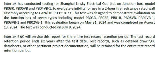

Looking for a general consensus on the acceptability of plastic boxes being used without firestops where 3.1.9.4. (NBC2015) specifically says anything other than noncombustible boxes installed as per 3.1.9.4.(2) must be firestopped... I've got some Intertek test reports from their lab in China to say that they'll be okay for up to 2-hours in a wall assembly, but the testing standards are all UL - not ULC and not any of the UL standards noted in 1.3.1.2. - and I've refused to accept thus far unless they can give me a test report showing either noncombustible per CAN/ULC-S114 or acceptable performance in a rated wall assembly per CAN/ULC-S101.

S115, which again seems odd to me as the box is the penetrant and also the firestop..? I've contact ULC and Intertek Canada to try and speak with someone that knows more about S115 as I can't find a copy to review, but Standards Council of Canada doesn't list Intertek's Shanghai office as an accredited testing service location, which is where the report comes from.
