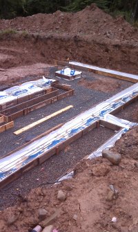

Can you tell me if this is a violation of the NEC IF the contractor chooses to bond to the rebar only and does not use ground rods? If so, what section?
why in the world are they using the fabric under the footings? Is the use of tyvek type materials being considered a crawl space vapor barrier and are they sealing to this material? A proper UFER is important because in today's world the incoming water service lines are usually plastic materials then transitioning to other plastic materials approved for interior piping. We have been using the frost protected shallow foundation method (insulated slab on grade) for some time. And there is a requirement for the vapor retarder under the slab so that you do not have moist floors. Most prefer this because they want in-floor heat. So anywhere there is a UFER I make them take out any vapor retarder that occurs in the footing area.
interesting point the informational note does not state "the bottom of the footing" and just above the info note the description includes "...vertical foundations..." . I have always felt that the best footings are bound by soil to their tops. But our excavation methods now days leave all of the interior footing at the surface.
I would like to hear why anyone would be putting the fabric in the footing to begin with

A membrane might be used because they are concerned about moisture from the ground passing through the slab and foundation thus causing failure of linoleum or promoting mold under the carpet. These were big concerns several years ago. I have seen a membrane used when building was built on a site where there might be residual contaminants in the soil.
The water lines have been converted to plastic pipe because when connected to the house ground there were currents passing through the water lines which resulted in corrosion of the water pipes.
The NEC provides for several types of ground electrode. The choice of which one will be used is that of the permit applicant. A building official that tries to dictate that a certain type of ground be used is overstepping.
Under normal circumstances where the footer was in direct contact with the earth and not separated by a barrier as stated in NEC 250.52, they would not have to use another method as a grounding electrode but since the steel in the footer no longer qualifies as a grounding electrode, they must install another one of their choice.
Oh, I think you are missing the point. Look a little closer.......
Jeff, I was seeing what looked like a conductor in the "middle" section going to the rebar where there is no "footingwrap".....If that piece was 20' I would have to approve the installation I believe....
Wrong. Again. I've copied/pasted you the code language myself at least twice.

Jar,
My Soars book on grounding under an Informational note states:
"Concrete installed with insulation, vapor barriers, films or similar items separating the concrete from earth is NOT considered to be in 'direct contact' with the earth.
Using a vapor barrier between the concrete and the earth would render the electrode ineffective.
