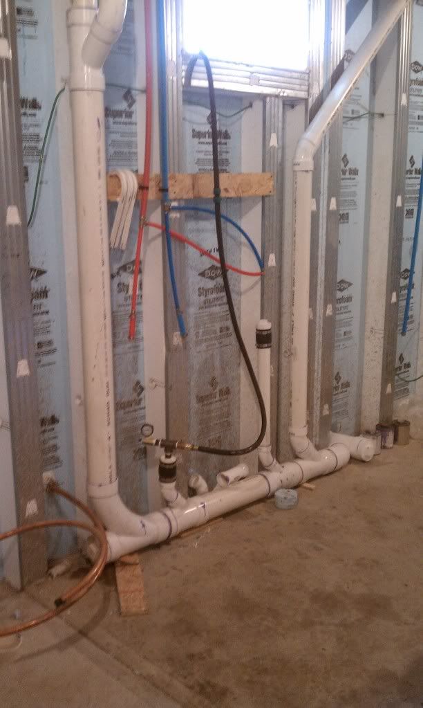

Just something to look at and comment about:
I'll start with a few comments:
[1] Air testing of pvc pipe is a "no no!"
[2] What, ...they couldn't put the piping ' inside ' the stud cavities?
[3] Those clean outs are going to be a problem for whoever opens
them up for augering.
[4] The piping is not fastened in place. ...anywhere!
1) It was water tested and he attached the gauge at the bottom to see what the pressure was with 10' of head
2) Superior walls, concrete webs
3) I agree completely
4) I agree completely
Francis - the pressure is 10' of head! (which equals 4.33 psig) But somehow I detect enough sarcasm in your question to indicate that you knew that!
jar - how could the pressure be anything other than 10' of head (=4.33 psig) when there is 10' of head on the system? Static head is dependent only upon the height of the water column in this case.
Going in reverse.... it would take 2.31 vertical feet of pipe to have 1 pound of pressure. So as VP stated 1 foot vertical equals roughly 4.33 psig. That is why the code allows 5 pounds of air pressure on a test in lieu of 10 feet of head pressure.
Love those superior walls!! Any plumber that use's the j hooks is getting out of the gate on the right foot. No idea why the 2 vertical dead ends. Strap all piping per table and all is good.
I’m not good with math as I used to be and as I should be. Normally I would see a single head of water, this photo shows at least 3 verticals over 10’ tied together, I wonder if lets say there are two joined stacks filled to 10’, does this give the same pressure as a single 20’ of head?
Vegas Paul, I appreciate the constructive criticism of how I ask the question, it is just as important as knowing what to ask. Something I need to improve on.
Two joined stacks at 10' yield the same pressure as one single 10' stack... regardless of diameter or # of stacks, the height is the only important factor for static head.

If he only added the gauge to see what the head pressure is, then what is the black hose for?
