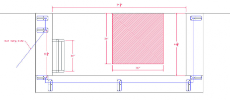

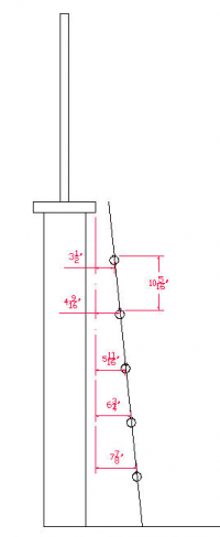

It is rare for us to make these, but this project requires one since the window well is 62" deep.Here in lies my question, since we are installing a gate at the top that swings outward that is part of the guard, how do you all feel about the ladder being built on about a 6 degree angle.I was thinking it would keep the person leaning forwarddo you see a conflict here within the code?
As long as it allows the window to fully open, and doesn't encroach more than 6" into the required clearance (read 30" from window) I believe it is acceptable.

mj
If it were me trying to descend that ladder, I would want some more
tilt to it ( at the top ), ..towards the window well itself. But that
is just me, others may have their own preference. If not more at
the top, then maybe some more away from the wall at the bottom.
It looks like it meets the letter & intent of Section R310.2.1, 2006
IRC.
Good idea, just one small problem - the window well will need to be enlarged by 1 1/8" to meet this requirement - Exception: The ladder or steps required by Section R310.2.1 shall be permitted to encroach a maximum of 6 inches (152 mm) into the required dimensions of the window well.

If it were me trying to descend that ladder, I would want some moretilt to it ( at the top ), ..towards the window well itself. But that
IRC..
Your preference isn't required by Code. It could be completely vertical and comply.
Not necessarily. We don't know how far from the window the bottom of the ladder is. As long as it's not less than 30", it's good.

I should have posted this pic also,
There is just under 28 sqft in the window well and the ladder would not interfere with the 9 sqft, but would extend more than 6" as note by Bob, but not in to the required space.

Just wondering, is a window well egress ladder required to meet a weight limit requirement? other than that, post #8 looks complaint to me!
pc1
it could be a ships ladder as long as one can get out of the well. The distance above the bottom of the well and the first rung (as well as it's construction) depends on the people who will be using it. How often do we use "site made" ladders (which OSHA approves) on a commercial construction site? Me... alot.
