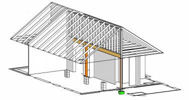

Hello Everyone,
Hope you are all doing well. I am new to the forum. Thanks for having me.
I have a 24'x36' one story, 1940's brick veneer house in Nashville. Bearing wall runs down the middle of the 36' length. 3 concrete block piers support the triple 2x10 beam. The piers are way off center of the pad footers and hang over the footer by 2 or3 inches. Amazingly, the tops of the 3 piers are all the same and seem to have not moved in the last 80 years. And the block are plumb and level. The footer are only 2 or 3 inches thick and not thick enough to drill into for adding rebar.
I need to add a post to the center pier for a new load bearing beam 8' up from the finish floor and the old footer will not support the load. I have pondered this for a few days now and I have come to the conclusion that I need to remove the old footer and start over - unless you good people can enlighten me on a way to reinforce the existing footers. Is there a way to save and add onto the old footers? Or should I tear it out and start over?
I have photos, but cant figure out how to attach them to my thread.
Thanks Very Much,
Russell

I know what I am gonna do. I'd rather not take out the old, so I am going to add to the existing with a 1x6x24"x30" form around the block and rebar through the side of the block and then down and into the old footer.and try to get some rebar into the bedrock. And then pour concrete 5-1/2" up onto the block.
There are civil or structural engineers in Nashville. Smaller offices are more likely to be interested in this project.
The engineer will need to understand what is the real problem and what needs to be changed. The engineer will then help you decide what really needs to be done.
If this has been there for 80 years what has changed and why?
From your description the existing framing seems funky but why do you feel the need to change it now?
I am not convinced that your solution will be effective. There are likely easier solutions. If you are on real rock you do not need a footing to transfer the loads to the rock.

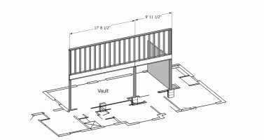

Thanks, Mark K. I don't like the way the block hangs over the edge of the footer. I am adding an LVL beam at ceiling height and I want to put a 2x6 wall on top of the LVL and run it up to the ridge. Then I'd like to vault the open portion. I'm thinking that center pier is going to take on a heavier load and hence my wanting to beef it up.

are outside the prescriptive Residential codes, ...you will
need to employ a structural engineer to design you something
specific to your application and location..........There are
too many variables for anyone on this Forum to be able
to provide you a specific, Code compliant, safe design.
