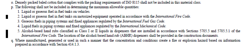

Fuel in vehicles for engine operations exempt from MAQ, fuel in dispensing tanks is include in MAQ for storage of vehicles, not for servicing vehicles
2015 IBC table 307.1(1)
Massachusetts rub, if you are servicing the fuel oil truck in a building, the gallon capacity of the delivery tank does not count to calculating fire sprinkler requirements, the building is considered a motor vehicle repair garage S1 0.20GPSf. If you have storage of fuel in the building over 660 Gallons in a sprinkler build the it it a H use group and have to up the sprinkler design considerably.

I think that settles it. Thanks commish. I spent the last few hours of the day looking for just this type of thing, even read the footnotes listed on the flammable gas and combustible liquids lines, but totally missed the footnotes applicable to the entire table. I would consider all the efforts I spent on this (and all of you) a waste in light of how simple it could have been had I noticed this, but it was a good learning experience for me, and I never consider that a waste.
