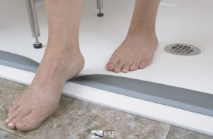

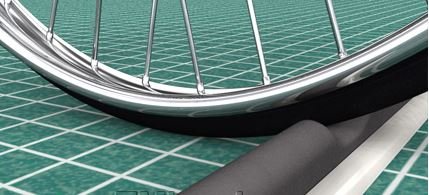

The first part of the first sentence of this section allows for a shower receptor to not have a curb. This is necessary to enable “zero height threshold” shower receptors to be installed for wheelchair access or for ease of access for disable users. If the shower receptor is to be designed with a threshold, this section requires that the top of the threshold be not less than 1 inch below the sides and back of the receptor. This is required so that if the drain should clog, water will overflow the threshold before overflowing the back or sides of the receptor. With respect to the top of the drain, the top of the curb cannot be less than 2 inches above the drain. This allows for some amount of water storage in the receptor so that if the drain is sluggish or a washcloth is accidently dropped over the drain, the user will notice the accumulation of water on the floor before water begins flowing over the threshold. There is also a maximum height of the top of the threshold above the drain of 9 inches so that the user does not have to step too far down into the receptor.
The pictures below are types of collapsible threshold approximate 1 ⅜ - inch height.
