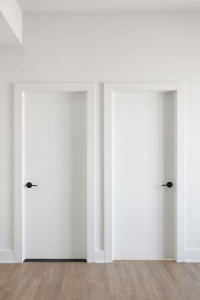

I have the same feeling Sifu...It makes me pretty uncomfortable to disagree with RLGA, but I think I do. If I were in both rooms I could readily distinguish the white doors but not the mural door. Though I see the point, and had never considered it before. When I quickly went between the two pictures it became more clear. If the mural is compliant, I have to ask myself what wouldn't be? The code is subjective with "readily distinguishable" and "easily recognizable" but doesn't specifically mention paint. Is rainbow paint a decoration where white paint is not? I guess I think it is.
DARN, another good example. Being perfectly honest, in every day life I have had trouble locating the store-front door in a wall of glazing, but I have never considered it to be a code violation. Having exit signs have always made the difference, and of the space is small enough to not require them, then it is small enough that it doesn't present enough confusion. Now my brain will really hurt. No I'm not sure if I have been too strict, or not strict enough.Slippery slope....If they have exit signs I would worry too much....Would you regulate doors with sidelights? Storefront style?
