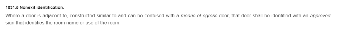

So this would be illegal, too?
The paint does not make it indistinguishable from the adjacent construction--the frame and the recess of the door surface does make it distinguishable. Like the door commercial, this door is compliant.
It would depend which door is the actual exit - if one door goes to the exit and the other goes to a storage closet - you may have an issue - not so much with the building code but perhaps ADA and/or fire code.
Fire Code for reference -
