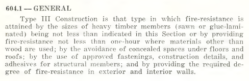

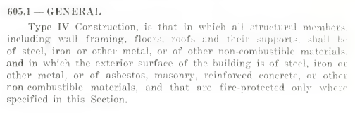

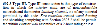

The construction type descriptions got bastardized back in the 1980s or 1990s, well before the ICC even existed.
When I started playing at being an architect in the 1970s, we were under an amended version of the BOCA Basic Building Code. I think it was what we now call type III that was named "Masonry Bearing--Ordinary Joisted," and it was specifically intended to cover buildings with load-bearing masonry exterior walls and wood floor and roof framing. Then, somewhere along the way, BOCA kept the basic classification and description but changed the name, opening up what had been an easily-understood construction type to other configuration. [Hmmm ... or that may have been type IV. Type III may have been Heavy Timber.]
In the SSBC, there were
and
And now we have the IBC, in which type III is

And notice nothing on bearing or not....
