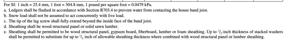

There is a mention of flashing for exterior decks in R507 but it only mentions minimum thickness and type of material, not that it has to be done or how it must be done. The roofing sections of the code are very good about this. I am surprised that as many revisions in R507 since its birth as a new section did not bring forth this requirement.
There are two figures, one shows what I can assume is flashing and the other figure calls out flashing but does not show it.
I am surprised that one of the major reasons for deck collapses is the failure at the band to ledger connection, most often due to rotting from a lack of flashing is not prominently listed as a requirement in R507. This is why I have always been a fan of the AWC DCA-6 manual which not only stipulates corrosion-resistant flashing but also requires stainless steel connectors for all decks built within 300' of salt water.

R507.2.4 Flashing.​
Flashing shall be corrosion-resistant metal of nominal thickness not less than 0.019 inch (0.48 mm) or approved nonmetallic material that is compatible with the substrate of the structure and the decking materials.
Screen Shot 2023-12-06 at 16.37.16.pngScreen Shot 2023-12-06 at 16.37.25.png
TABLE R507.9.1.3(1)
Footnote a. Ledgers shall be flashed in accordance with Section R703.4 to prevent water from contacting the house band joist.
TABLE R507.9.1.3(1)
A footnote? Footnote "b"
This should have its own section that is prominently displayed and not hidden in a footnote like a secret or at the very least in the code like this:
R507.9.1.1 Ledger details.​
Deck ledgers shall be a minimum 2-inch by 8-inch (51 mm by 203 mm) nominal, pressure-preservative-treated Southern pine, incised pressure-preservative-treated hem-fir, or approved, naturally durable, No. 2 grade or better lumber. Deck ledgers shall not support concentrated loads from beams or girders. Deck ledgers shall not be supported on stone or masonry veneer. Ledgers shall be flashed in accordance with Section R703.4 to prevent water from contacting the house band joist.
R703.4 Flashing.
Approved corrosion-resistant flashing shall be applied shingle-fashion in a manner to prevent entry of water into the wall cavity or penetration of water to the building structural framing components. Self-adhered membranes used as flashing shall comply with AAMA 711. Fluid-applied membranes used as flashing in exterior walls shall comply with AAMA 714. The flashing shall extend to the surface of the exterior wall finish.

Footnote a. You don't have footnote b. because the hurricanes blow the snow north.
