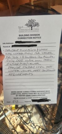

I am a homeowner in Newbury Park, CA and I'm having trouble with our building inspector saying we can only have 1 shower panel in our remodel, which is now months along, and this only came up at rough plumbing inspection. Attached is the note he gave our contractor. I don't see anywhere in the code anything about "one valve per drain"? and I definitely see reference to showers with multiple showerheads. Can you point me to something in the code I can see to support what he says? or could you give me something I could show him that 2 shower panels are permissible. Or am I misinterpreting the problem he wants corrected? Each shower panel has it's own valve and multiple different shower functions, and is rated 2.0 GPM. Now I understand if the panels are not permissible (I believe the standard was lowered to 1.8 GPM), but from all I've read I can have two of them.
Do the approved plans show two shower heads?
Have you called the Building Department and asked them for the code section you are alleged to be in violation of?

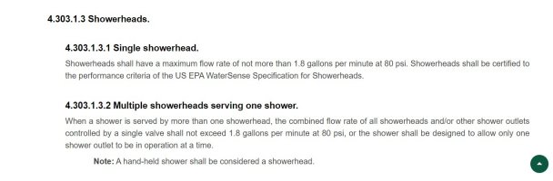

California Plumbing Code:
408.2.2 Multiple Showerheads Serving One Shower (BSC-CG, DSA-SS & DSA-SS/CC). When a shower is served by more than one showerhead, the combined flow rate of all showerheads and/or other shower outlets controlled by a single valve shall not exceed 1.8 gallons (6.81 L) per minute at 80 psi, or the shower shall be designed to allow only one shower outlet to be in operation at a time in compliance with Chapter 5, Division 5.3 of the California Green Building Standards Code (CALGreen).
I can't access the CALGreen standard, so I can't quote division 5.3. The plumbing code seems pretty clear: You can have multiple shower heads all operated by a single control valve if the combined flow doesn't exceed 1.8 GPM. You can have two shower heads and two valves if the two valves are somehow interlocked so that you can't operate both showerheads simultaneously.

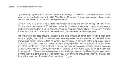

Division 5.3 has the exact same text as what you quoted. I found in an older document, Guide to the 2016 California Green Building Code Standard, published by the state, guidance which says each valve in a shower can have the max flow rate (at the time it was 2.0 GPM). The language of the earlier standard is exactly the same, except for the change from 2.0 GPM to 1.8 GPM. But I can't find anywhere that says to interpret it this way still. [bold type mine for emphasis]
"Section 4.303.1.3.2 addresses multiple showerheads serving one shower.
The specified flow rate of 2.0 gallons per minute at 80 psi also applies in
situations where one or more valves supply multiple showerheads in a single
shower enclosure or space. “Fixture types” or sources of water flow include,
but are not limited to, showerheads, handshowers and bodysprayers.
The maximum flow rate provisions apply to the total amount of water flow
resulting from each valve supplying the individual shower enclosure regardless
of the number of attached showerheads (or similar fixture outlets or
sprays). For example, if only one valve supplies a shower enclosure or
shower area , the maximum water flow, regardless of the number of showerheads
and other outlets, is 2.0 gpm at 80 psi. If two (or more) separate valves
provide water to separate showerheads and other outlets, the maximum flow
rate for each valve would be 2.0 gpm at 80 psi.
If the operation of two or
more showerheads and body sprays controlled by a single valve results in
more than 2.0 gpm at 80 psi total water flow, then only one showerhead may
operate at one time with a maximum flow rate of not more than 2.0 gpm."
Guides are not enforceable codes.
Codes usually get more restrictive with newer editions. I don't know why you would look at the 2016 CALGreen if that's not the edition that's currently in efect.

That second sentence is not how I read the quoted section of UPC 408.2.2. And CalGreen Code 5.303.3.3.2 "Multiple Showerheads Serving One Shower" has the same text:
When a shower is served by more than one showerhead, the combined flow rate of all showerheads and/or other shower outlets controlled by a single valve shall not exceed 1.8 gallons per minute at 80 psi, or the shower shall be designed to allow only one shower outlet to be in operation at a time.
I read the text up to the "or" as saying for any single valve, the outlets controlled by that valve shall not exceed 1.8 gpm at 80 psi, without restriction on the number of valves. If that text wanted to require that there only be a single valve, it should say "When a shower is served by more than one showerhead, the combined flow rate of all showerheads and/or other shower outlets shall be controlled by a single valve and shall not exceed 1.8 gpm at 80 psi; or . . . ."
Basically as written "a single valve" = "any single valve" = "any one valve."

But that isn't what the code says. The earlier guidance (published by the state & ICC) on identical text says explicitly that a shower can have 2 (or more) valves with each having the max GPM. What the max GPM is has changed, but I find nothing anywhere that leads me to believe the earlier guidance has. The language regarding making them so only one operates at a time is referring to two heads controlled from the same valve, as the guidance says, explicitly. Your condescending dismissal of my positions does nothing to help me. It doesn't show me any evidence that something beyond the max GPM has changed. I've searched online for anything clarifying this in either direction. If it's changed there's gotta be something somewhere that says so.

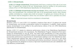

After much late night searching, I was able to find the guide to the 2022 CalGreen Building Standards Code, and it says the exact same thing. So it's manifestly clear you can have more than one valve per shower.
All that being said, what about the one valve per drain? I cant find anything referencing this in either CalGreen, or the California Plumbing Code, but most of the images I see of double showers do have two drains.
