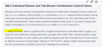

I don't know if gang showers are still being done in school, but they definitely still exist in the California Plumbing Code:
the more I think about it, this inspector might be trying to offer a workaround on the code limitations:
Two drains enables him to imply a "gang shower", and now two showers can operate simultaneously, each at 1.8 GPM.
Being a bit devious for the moment:
What if you took a regular shower drain grate and screwed a little divider onto it, making it into "two" drains at time of inspection?
Not necessary, as the quoted code sections provide for a limit of 1.8 gpm per shower valve, regardless of the number of drains.
