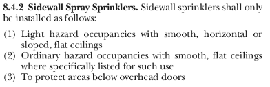

Sidewall sprinkler heads / obstruction
From 2016 NFPA 13;::
My non engineer opinion you do not have a smooth ceiling

In the 2016 edition, if you are asking about 8.7.5.1.4.1
I take that to be an obstruction in front of the sprinkler, like a solid beam hanging from the ceiling.
But, 8.7.5.2.1.1 says apply the eighteen inch rule. Which is like the storage rule below sprinklers.
Does say an exception is three inch pipe or less,,,,, which your set up does not meet.
