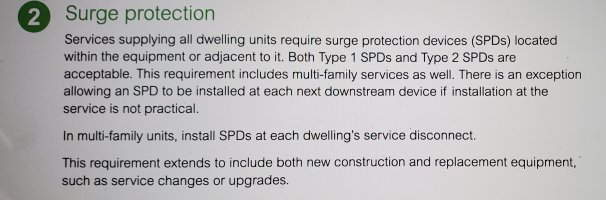

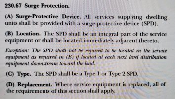

So every residence is Req to have surge protection equipment installed? That's certainly a significant change and actually quite an expensive one in some cases. I wonder at what level will resonances be Req to update to meet this requirement during renovations?

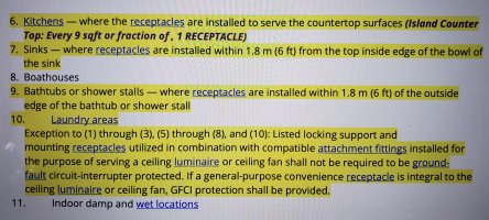

Remember CALIFORNIA is three years behind the 2022 Electric code is based on the 2020 NEC.The requirements for GFCI have changed. #5 Basements is now the entire basement whereas it was just the uninhabitable portion previously.
#7 is new. It sounds like the definition of a kitchen but since it is a stand alone location it must be something other than a kitchen.
#12 is new. There is a cause for concern with #12 because this provision will require discernment on the part of the inspector.
The photo above is from the NEC. The photo below is from the CALBO training handout. Note that #7 in the NEC version is not in the CALBO version.

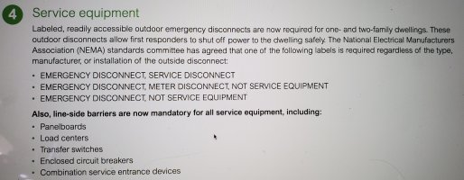

I've lived in New York, South Carolina, North Carolina and Kentucky have never seen an outdoor disconnect for power other than the meter itself which is pulled sometimes in an emergency! What kind of disconnects are Req in California, obviously they have to be weatherproof. Also what kind of requirements that are going to be for locating this device so that emergency service personnel can easily find them?Southern California has had outdoor service disconnects for as long as I can remember. Now everybody will.
Thanks Mark. I did get ahead of the game. I'll try to fix it.Remember CALIFORNIA is three years behind the 2022 Electric code is based on the 2020 NEC.
#11 is new. There is a cause for concern with #11 because this provision will require discernment on the part of the inspector. An inspector asks for a wet location whatever and the contractor replies with, "There's no way that this is a wet location" to which the inspector says, "Ahhh, but is it a damp location?" There's not a lot of stuff that is made for a damp location. Dry and wet is pretty much it.
