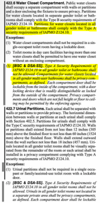

Single Occ restrooms in lieu of multi
I just found 2025 CPC 422.6 and 422.7, which outline what types of compartments are required. Type A security requirements remove the toe space, but only state-owned building are required to have floor-to-ceiling partition (because of the definition in CPC), at least the way I read it.
Well there you go! Spot on. This looks like the 2025 version.
