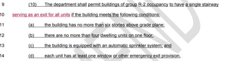

Our wonderful legislators are probably going to get this through. It passed the senate and now in the house.
Now what does the code require?
Full NFPA 13 system
Probably a Fire Pump
2 Hour rating for the stair
90 minute doors.
Type I construction if over 6 stories
Type II, III, or IV for 5 stories.
I will bet the state building codes division will cave and amend some of the above mentioned code requirements.
I used to think I would leave when they would nail the coffin shut, not anymore.
Full NFPA 13 system
90 minute doors.
Okay, construction type II, III, or IV for up to 5 stories. Type I for over 6 stories.
What construction type for 6 stories?
