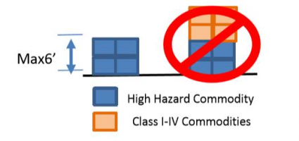

Once you go above six feet with tires, you are in the high hazard commodity area.
From there it is back to your original question of how many sq ft is designated for tire storage.

The storage of combustible materials in closely packed piles, on pallets, in racks, or on shelves where the top of storage is greater than 12 feet in height. High-piled combustible storage also includes certain high-hazard commodities, such as rubber tires, Group A plastics, flammable and combustible liquids, idle pallets, and similar commodities where the top of storage is greater than 6 feet in height. CFC 3202 Note: To be considered non-high pile combustible storage for high hazard commodities < 6 feet there cannot be any storage above it.
