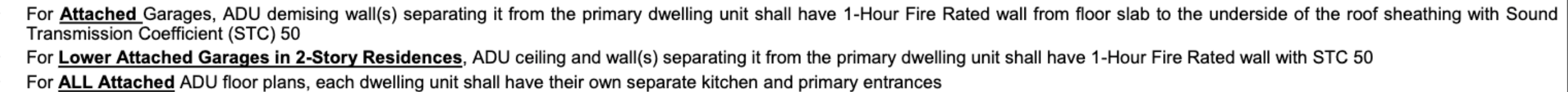

LA County has standard notes and details for garage conversion ADUs and Junior ADUs
https://dpw.lacounty.gov/bsd/lib/fp/Building/Residential/Accessory Dwelling Units/Garage Conversion to ADU & JADU Standard Notes and Details.pdf
There you will find the required STC 50 for the garage conversion ADU and no requirement for the JADU. I realize that this is no help outside of LA County but it ca,me from somewhere or LA County probably wouldn't require it.... But I should point out that there is more than a few goofy things in the document... for example, why would a JADU not have a fire rated separation and STC 50?
I think that might be because a JADU is allowed to share facilities such as a laundry room, which is absolutely ridiculous because it essentially becomes no more significant than a room in a house. The only thing I see a JADU is providing is a second address and the ability to claim a "second" unit. Code wise it's not a separate dwelling unit if there is shared access.
I wasn't aware of the shared laundry ... they also can share a bathroom.
