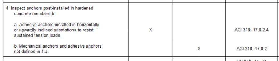

According the IBC Table 1705.3, adhesive anchors installed in a horizontal position call for continuous special inspection. "Continuous" means the special inspector must be present and watching at all times the work is being performed.
Fail.
I believe these are vertical rods and not "upwardly inclined" rods resisting sustained tension loads.
Therefore "b" would be the appropriate reference which is periodic inspection.
You're right. It was late when I looked at it last night and I didn't see the holes. I was considering this as horizontal dowels into the cut edge of the slab. So, yes -- periodic inspection.
