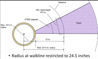

In R311.7.10.1 what does a maximum walkline radius of 24 1/2" mean or have to do with anything? Is it saying that at the 24 1/2" walkline radius the min tread depth is 6 3/4"?
R311.7.10.1 Spiral Stairways
Spiral stairways are permitted, provided that the clear width at and below the handrail is not less than 26 inches (660 mm) and the walkline radius is not greater than 241/2 inches (622 mm). Each tread shall have a depth of not less than 63/4 inches (171 mm) at the walkline. All treads shall be identical, and the rise shall be not more than 91/2 inches (241 mm). Headroom shall be not less than 6 feet 6 inches (1982 mm).

Yes, it means that at the 24 1/2" maximum radius of where the walkline would be, the minimum tread depth is 6 3/4".
Walkline is the arc that is located 12" from the inside stringer.
The significance of the 24 1/2" measurement is that it sets a limit to the dimension of where the inside stringer is placed which is at maximum (24 1/2" minus 12"... ) 12 1/2" from center of the spiral stair. This limit then removes the ambiguity of what would technically be considered a spiral stair by code.
This is valuable information to us because spiral staircases cannot be used as the primary means to access an upper floor due to its limitations and would still necessitate another more conventional stair to be paired with it for example.
So exceeding the 24 1/2" radius will technically move you away from the stair being a spiral staircase and more as a curved staircase which opens you up to using the staircase as your primary stair and not just a decorative element.
