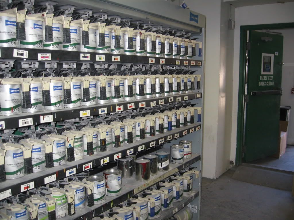

Other side of same room!

Your second photograph is a pigment rack. Its most likely exempt if the pigments meet the exception in Section 3405.1. They will need to provide you with fire point data in this case.

Rjj,
I see that you were so busy citing that you left the doors open or their self closers should need attention or remove the cardboard box wedges. Is that a hasp lock on the door?
