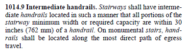

Looking at 1014.9:
Question: Does this qualify as a monumental stair? it sure has the dimensions, but providing steps to a viewing platform I would not consider monumental
Do I need to install intermediate railing every 5 ft?

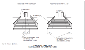

2021 IBC Commentary on 1014.9 Intermediate Handrails (partial quote)
The criteria for monumental egress stairways deal with the very wide stairway in relation to the required width.
With that commentary in mind, sounds like this is a monumental stairway. Therefore I would say that, per 1014.9, the handrails must be located along the most direct path of egress travel. But with the relatively great width I have in my mind, sounds like that may be open to interpretation.

No. 1014.9 says that only the part of the stairway minimum width or required capacity have to be within 30” of a handrail. With 60 occupants that’s 60 x 0.30”/occupant = 18”, therefore minimum width by component will apply, that’s 44” per 1011.2. Then you need to look at your plan, determine what you think is the “most direct path of egress travel,” and set your handrails there.
