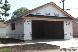

I would excavate the driveway to allow a garage at sidewalk level and convert original garage into living space. other option would be to abandon driveway and rely on street parking only.
