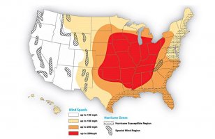

Where is figure 304.2(1)?
cda, I'm confused? :confused:
A Group "E" occupancy with an occupant load greater than 250 falls into Risk Category III according to Table 1604.5. All that to say it does not fall into Categories II or IV. All that to say, I don't care so much.
2018 IBC 423.4
A Group "E" occupancy with an occupant load greater than 50 shall have a storm shelter constructed in accordance with ICC 500. This only applies to those areas where the shelter design wind speed for TORNADOS (not hurricanes or New Jersey or Alaska or ... ) is 250 mph in accordance with Figure 304.2(1) of ICC 500.
FEMA-ICC 500 304.2(1)
