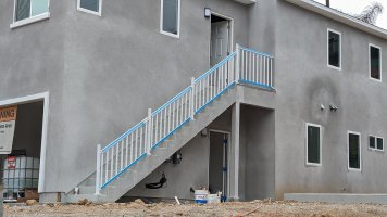

Have you checked if the railing manufacturer sells handrails to go with their railings?I purchased a kit for a continuous handrail but the handrail brackets are wider than the posts. The posts are about 3" wide while the brackets are about 3.5" wide round.
Any suggestions on making or buying a continuous handrail for these exterior stairs?

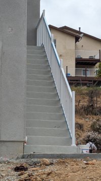

Like I mentioned in your original post....................attach a continuous handrail to the building not the guardrail assembly. much easier

You could consider mounting the handrail to the wall but my preference would have been to avoid putting any extra holes in the wall unless absolutely necessary. If you attached the handrail to the wall you’d have to make sure you have adequate reinforcing in the wall which might not be possible.
