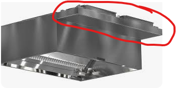

suspended MAU registers within a suspended ceiling grid

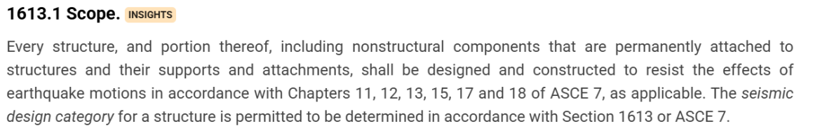

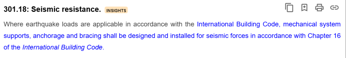

Since you are in CA and probably a seismic zone "D" I would think ASCE 7 would apply
2021 IMC
2021 IBC
Non Structural Components would include HVAC systems
Make Up Air unit
