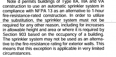

According to Table 601, under IIIA we are allowed to have a primary structure of 1 hour. Per 704.10, if the structural members are located within the exterior wall they are required to to have the fire rating for exterior bearing walls based on IIIA (2hrs).
So now I have a steel structure within a 2hr exterior wall assembly , but footnote d says that with an approved automatic sprinkler system can be substituted for 1hr fire resistance rated construction as long as the system is not otherwise required by other provisions of the code. We do not need to use the sprinkler system to expand floor area or height. But does that fact that section 903 require sprinklers in R occupancy count as "being required by other provisions of the code"?
The thinking was that if the steel structure is within the 2hr exterior assembly, and we have sprinklers that we could use the sprinklers to bring the 2hr assembly down to 1hr. Any insight?
Cannot use the exception to reduce the fire-resistance rating of the exterior wall.
d. An approved automatic sprinkler system in accordance with Section 903.3.1.1 shall be allowed to be substituted for 1-hour fire-resistance-rated construction, provided such system is not otherwise required by other provisions of the code or used for an allowable area increase in accordance with Section 506.3 or an allowable height increase in accordance with Section 504.2. The 1-hour substitution for the fire resistance of exterior walls shall not be permitted.
As a kind reminder 903.3.1.1 is specific to NFPA 13; 903.3.1.2 is a 13R system permitted for Group R as applicable.
Ahh--I kept reading that lats bit of "d." as exterior bearing walls, not as exterior walls. This is very clear. Thanks, Francis!
