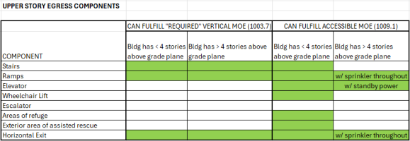

1. Single egress (unmodified) allows no emergency lighting.
2. It's an emergency response issue with people running out at the same time the FD is running in possibly
3. And the discussion that came up yesterday is this. Your first 2 MOE need to be accessible per 1009.1
1009.1 Accessible means of egress required.​
Accessible means of egress shall comply with this section. Accessible spaces shall be provided with not less than one accessible means of egress. Where more than one means of egress is required by Section 1006.2 or 1006.3 from any accessible space, each accessible portion of the space shall be served by not less than two accessible means of egress.
Generally, we don't want to use elevators as an MOE, but we also understand they are required at times (accessible floors 4th and higher):
1003.7 Elevators, escalators and moving walks.​
Elevators, escalators and moving walks shall not be used as a component of a required means of egress from any other part of the building.
Exception: Elevators used as an accessible means of egress in accordance with Section 1009.4.
1009.2.1 Elevators required.​
In buildings where a required accessible floor or occupied roof is four or more stories above or below a level of exit discharge, not less than one required accessible means of egress shall be an elevator complying with Section 1009.4.
Exceptions:
  1. 1.In buildings equipped throughout with an automatic sprinkler system installed in accordance with Section 903.3.1.1 or 903.3.1.2, the elevator shall not be required on floors provided with a horizontal exit and located at or above the levels of exit discharge.
  2. 2.In buildings equipped throughout with an automatic sprinkler system installed in accordance with Section 903.3.1.1 or 903.3.1.2, the elevator shall not be required on floors provided with a ramp conforming to the provisions of Section 1012.
Sooooooo....We don't need stairs in a 5 story (depending on level of exit discharge) building as we have the elevator for egress....Discuss? Think of the square footage the developers are going to save....

Corrected above..TY...CT was looking at 5 over 1 being allowed with single egress and we may be pulling that back to 4 total, so it could be moot for us....
But what about one elevator? Do you agree as written in the code (with the sections posted above) that the single MOE could be the AMOE elevator?
I will say an emphatic NO! to the only MOE being an elevator. I just see people panicking waiting for the elevator to stop at their floor only for the door to open and its full of people. Or people cramming into the elevator and then someone getting stuck in the door. This seems like way too risky of a move. Also, is insurance companies going to stand for this? I'm sure raising rates on building owners due to lack of exits would have a greater cost impact than the cost of losing rentable/leasable floor space.
But do you have a code section to back that up? If places are adopting some version of this they have to be very clear...Base code does not differentiate between AMOE and MOE really or AMOE stairs vs. AMOE elevator.
Here's the code path you asked for:
Elevators can't be used for a required means of egress. MOE is a defined term:
Lets see what an exit access, exit and exit discharge is considered now:
Sorry, but the three components of MOE do not include elevator as one of them. Remember that one cannot travel more than one story to reach an exit per 1006.3.2 Path of Egress Travel. Elevator is not one of the seven exceptions.

They did not amend AMOE sections. So if they exceed 4 stories above the level of exit discharge they still must install the elevator.
They did not amend 1003.7, which prohibits an elevator as the general means of egress.

Read the exception to 1003.7....
An elevator AMOE is exit access pretty much by definition:
[BE]ACCESSIBLE MEANS OF EGRESS. A continuous and unobstructed way of egress travel from any accessible point in a building or facility to a public way.
But the 1006.3.2 section does sort of work (to force the stair)....And this is why I said wording and location of these amendments will be critical....It is an AMOE can be an MOE as long as it is an AMOE, but it is not an exit.....Can we agree?

How is everyone ignoring the exception to 1003.7?
I just read that exception as allowing it to be an accessible MOE, not that it allows it to be any or the only MOE.

Joe B., I agree. Steveray, I concede that 1003.7 and its exception is poorly written. It might be better to say:
"Elevators, escalators and moving sidewalks shall not be used in determining capacity of portions of the means of egress system required by 1005."
Try this thought exercise - - pretend the elevator IS a required MOE component per 1005. How do you figure out the capacity of the elevator vs. the occupant load on a story?
Most exit components are measured in inches of width, which assumes a steady stream of occupants who are able to exit at their own pace. With the exception of some persons with disabilities, they are not waiting for an elevator door to open up in order for them to exit safely. from their floor level. They just take the stairs.
The only exit component where the exit capacity is determined from floor area instead of inches of width is a Horizontal Exit. They are required to have a refuge area on the other side of the door of 3 SF per person. If you used that on a typical 3500# elevator cab, that works out to a max capacity of 17 people. That doesn't even take into account that in an emergency, the 18th person is either frantically pushing the "door open" button, so the elevator never descends; or they are too late, stuck until the elevator returns.
There is only one part of the code that recognizes elevators can be used for self-evacuation, and that's in high-rise buildings. Even in that scenario, they are only utilized as a substitute for not doing an additional stair BEYOND all the other normally required stairs.
