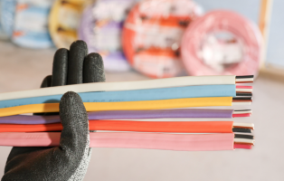

Originally, all NM cables had white outer jackets regardless of wire gauge. This lack of differentiation sometimes led to confusion, requiring electricians to check the embossed markings on the cable jacket to determine the conductor size.
In 2001, the industry implemented a voluntary color-coding system to simplify this identification process. While not mandated by the National Electrical Code (NEC) or UL 719, the change was widely adopted across manufacturers. The following standard colors emerged for NM-B cables:
  • 14 AWG (14/2, 14/3)White
  • 12 AWG (12/2, 12/3)Yellow
  • 10 AWG (10/2, 10/3)Orange
This system allowed electricians and inspectors to quickly differentiate wire sizes, improving efficiency and reducing the risk of installation errors. Over time, 10/3 cable also adopted an orange jacket, further solidifying color-coding practices in the industry.
Recent Developments in NM Cable Color Coding
In recent years, manufacturers have introduced additional color variations for NM-B cables, particularly for configurations with three conductors. This was initiated by Southwire, a leading cable manufacturer, as a way to further distinguish different cable types.
The updated color-coding scheme introduced by Southwire is as follows:
  • 14/2 → White (unchanged)
  • 14/3 → Blue
  • 12/2 → Yellow (unchanged)
  • 12/3 → Purple
  • 10/2 → Orange (unchanged)
  • 10/3 → Pink
This revision makes it easier to differentiate between two-conductor and three-conductor cables, reducing confusion during installation and inspections.
