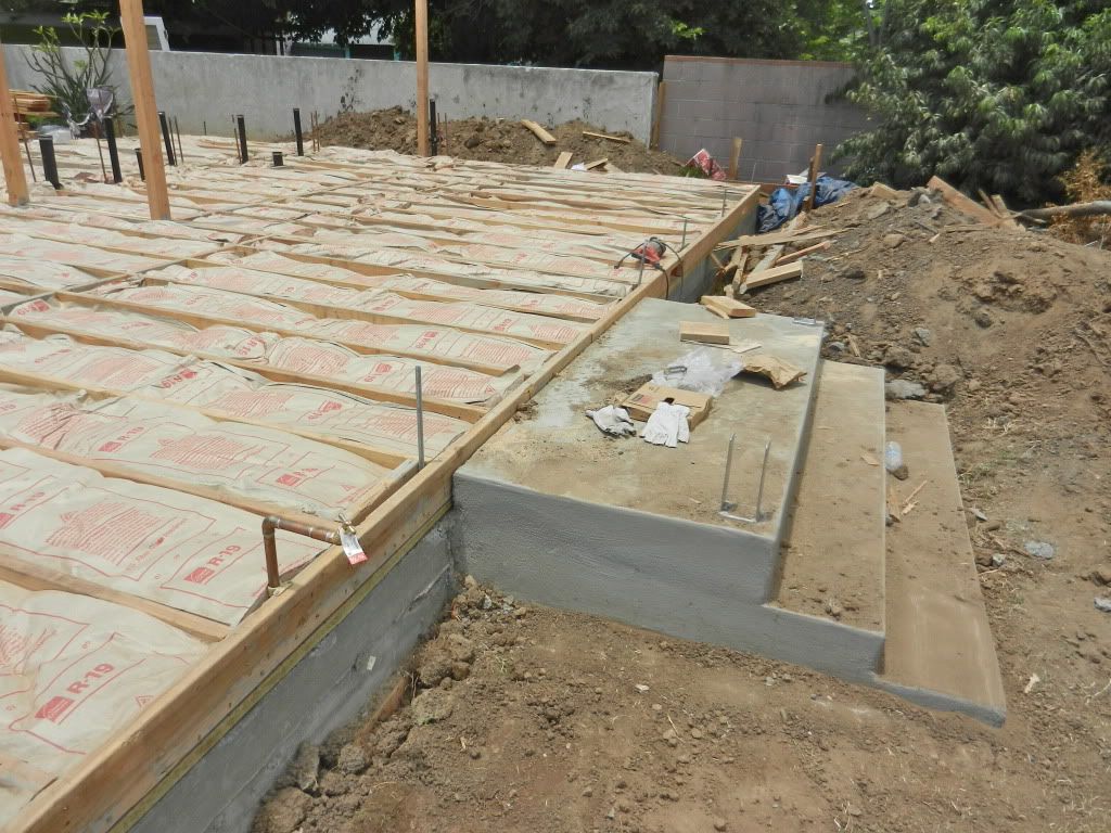

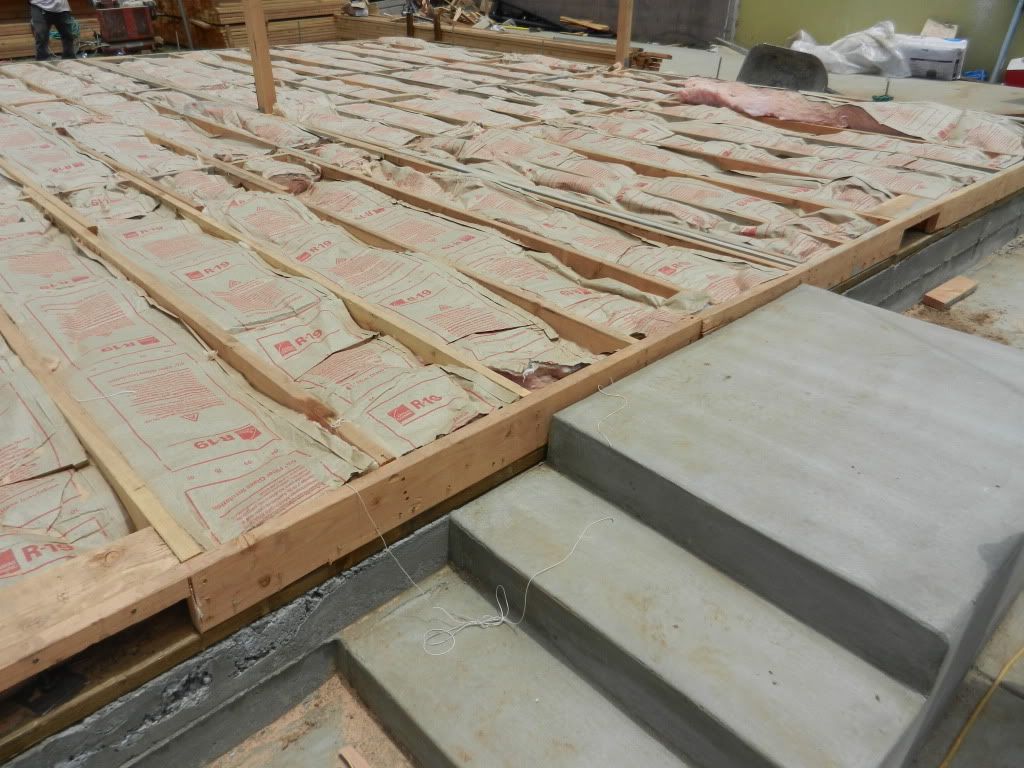

The porch is usually the last thing that gets done. Not now! Not like this! You've gotta drag most of the house through the door and it's gonna get tore up. Oh! You should have met the crew. This job will produce some pictures for sure.
And what's with the knife blades sticking straight up.
I believe the insulation is upside down. The vapor barrier/paper should be facing the moist ground in the crawlspace and the insulation should be incontact with the floor sheathing

Floor insulation shall be installed to maintain permanent contact with the underside of the subfloor decking.

How, where, and whether a vapor barrier should be used depends on the climate and by geographical location.
Looks like the concrete landing is in contact with the rim joist.

True but it is still wrong according to code because the insulation does not maintain permanent contact with the underside of the subfloor.
Should at least be a moisture barrier on the crawlspace side to protect the insulation from moisture
warning on paper says not to be left exposed. paper faces subfloor here or unfaced is acceptable in a vented crawlspace.
Here, because we have cold winters, the vapor barrier on ground is usually visquine and the paper side of the insulation faces the conditioned space.

The can probably get the 26 GA. GALV. FLASHING between the rim and concrete
Flashing would need to extend well below the mud sill and the larger landing it too tight to the rim to get anything in. They want to set a 2" L flashing in mastic. My concern is about water getting behind the concrete and it will over time. I am not a fan of mastic and caulking as a replacement for flashing.
