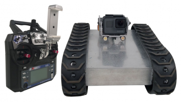

https://www.superdroidrobots.com/sh...ess-tracked-inspection-robot-with-gopro/2568/
Inspection Robots
Equipped with cameras, these robots are made to inspect tight spaces. Remote Inspection - Remotely inspect areas that are not easily accessible to people. Record the video in Full HD on the provided GoPro Hero5 and SD Card using your smartphone to view and control the video.
Entry into difficult areas - This tracked robot is very quick and has the ability to traverse many obstacles that often stop other robots.
Crawl Space and Attic Inspection - Compact and lightweight to easily fit into crawl spaces or attics. Video is viewed using WiFi between your smartphone and the GoPro Hero5 or Hero6. A wireless signal must be maintained. Not recommended for pipes, culverts, long distances, etc. where Wi-Fi will not work.
I want that - I am getting so that crawl spaces are no fun anymore.
