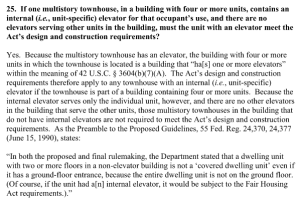

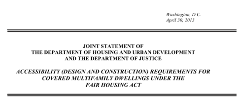

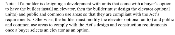

I found the FHA requirements, and regardless of any workarounds with the building department, you are already on the hook (civil liability) for FHA compliance, just because the units were sold on the basis of being elevator-capable. See the HUD/DOJ joint statement Q&A #25-27 at: https://www.hud.gov/sites/documents/JOINTSTATEMENT.PDF
Interesting. I had not seen that statement before now. Appreciate you sharing even though I don't love the content.
Yeah, it's all about presenting/marketing the options. As a thought experiment:
  • If the condos were built without marketing the unit internal elevator option, then a few years later a condo owner hires their own contractor to install an elevator, it would not be fair to force the other condo owners to alter their units into FHA compliance. So the HUD/DOJ statement does not get triggered by the condo owner's actions.
  • But if the developer designed AND marketed the condo as elevator-capable from the start, that's when all the condos are still under control of a single entity (the developer), not multiple condo owners.
  • There is nothing to prevent a developer from designing stacking closets and pit-friendly foundations in non-covered-multifamily-dwellings. That's not what triggers the FHA. But once you present a future elevator as an option to the buyers, that's what puts you on the hook for FHA compliance.
Sorry to be the messenger of bad news!

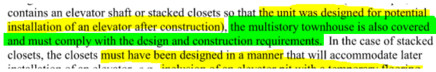

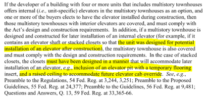

Why are you ignoring this sentence? It says that the whole unit is covered even if you don't install the elevator but you made preparations for it. It literally says there is no Catch 22.

Let's clarify:
1. The original post that stated this thread was about the South Carolina Building Code. I demonstrated in an earlier post #11 how the developer could comply by first completing the project as-is. Then the elevator could be permitted separately under the South Carolina Existing Building Code without triggering Type B path of travel compliance. Please review that post and let me know if you disagree.
2. Separately from the building code question in the original post, I looked into the civil rights issues related to compliance with the Fair Housing Act, which is typically not enforced by local building departments. They have presented the buyers with an option to install elevators, which is triggering FHA compliance.
3. So, there is a way to comply with chapter 11, but there is not a way to comply with FHA Design Manual. My disagreement with you was specifically limited to SCBC chapter 11 compliance.
